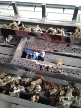

I'll try attaching a photo of the valve Assy. I have not yet gotten around to taking the fake wood out, so no pictures of the pilot light available at this time. It seems pretty standard, from what I can see of it. I found a troubleshooting guide, on line, and have been trying to follow it. I measured the output of the thermopile, and it is right at 325 millivolts, where it should be. The manual says that, if I flip the on-off switch, that is located above the valve, I should still read about 100 m-volts. The meter drops to zero when I turn the switch on, so I'm beginning to wonder if maybe the valve is bad?

Ok ignore everything I said in last post. That sounds too weak for your TP reading. How does your pilot light look?
