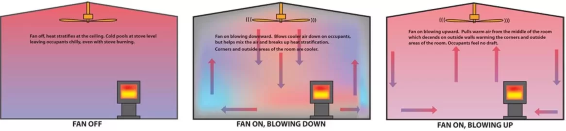

I believe another thing is that by running in reverse the breeze goes up across the ceiling and down the walls so you're less likely to actually feel the breeze like you would want to in summer running in normal mode. The hotter air is still higher winter or summer, you just don't want to feel that cooling from the air movement now. It may let you run them faster, moving more air and still be comfortable.
Edit; I see it says as much in last pic.
You should be able to reverse the flow to winter mode as i call it and at the same time increase the speed of the blades as you wont feel any actual breeze. This should help move the air around more evenly as shown in the picture. It's also the main reason fan manufacturers allow for reversing of the fan motor in the first place.
