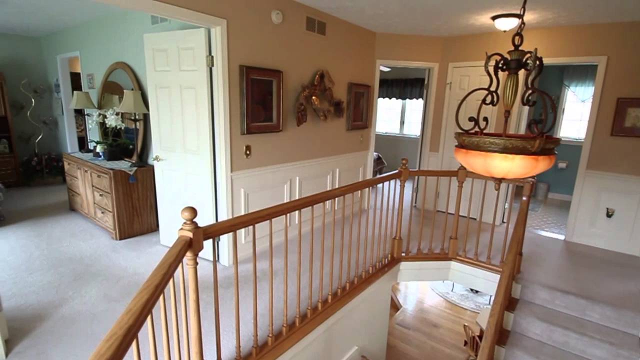

I have an enviro in a finished basement and we have been having trouble getting the air to flow up into the house. This picture is not my house but similar to how open our basement entry is.....there is no reason it shouldnt be rising. Ironically, as you come from the basement up you feel a literal temp transition as youre head crests the floor level (warm warm warm and notcieably cold). It seems to me if I lean over the railing I should feel waves of heat rolling up.....but nothing.
So this season we installed the OAK hoping that would help the sitaution. We finally had an opportunity for a test fire and NO improvement. Ive put fans top and bottom of the stairs, pushing and pulling hot or cold every which direction with very little difference.
I understand the idea of feed and returns, but with a completely open doorway/stairway how is it possible the air movement is completely stalled?? Its literally about a 15-20 deg temp difference and walking down the stairway is like stepping into a nice warm bath. Any ideas?? (Also I am not cutting in huge floor registers...as tempting as it is my wife would skin me).
