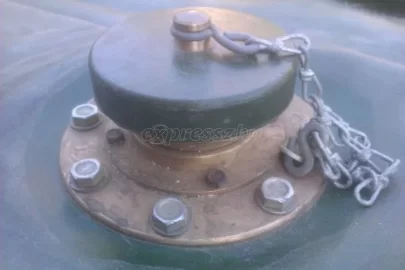

I found a tank, about 5000 litre which is 1320 us gallons, what do you guys think? about 1000 us dollars. I thought this would be good as when not using it in the summer I could use it as a hot tub, tile it and deck the sides :)

Is it Stainless steel? If it isn't you are going to have to line it some how. That being said it shouldn't be a huge deal to put a PVC liner in it but then you have to insulate it as well so you will have some money tied up...
K
its been painted, its not enough?
I don't know of any paint that can take being submerged in 200 degree water for any amount of time. I guess you could drain and touch up every year or two...
You will also have to use some sort of heat exchanger.

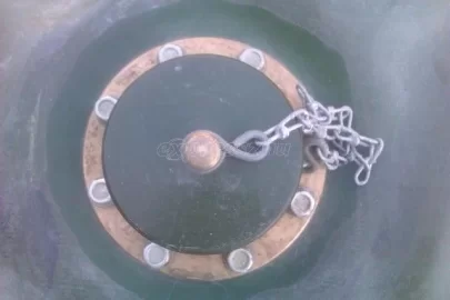

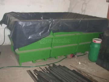

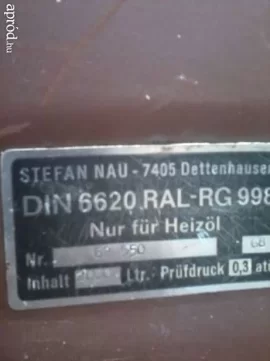

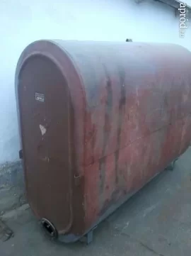

or I found this one a lot cheaper. It was originally used for heating oil, the seller says its been cleaned and is rust free...would this work?

Will this be for a pressurized or non-pressurized application?
Big difference in the tank you'll need - and I don't think you've mentioned yet.
(Either way stay away from oil tanks...)

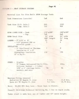

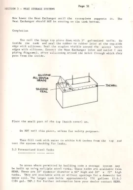

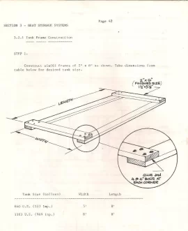

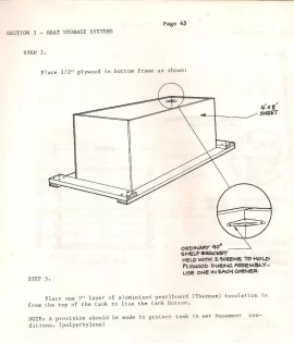

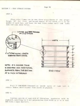

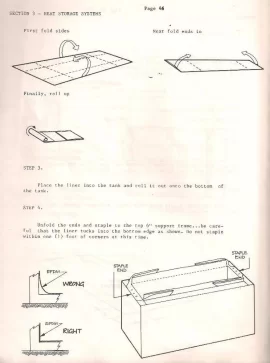

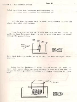

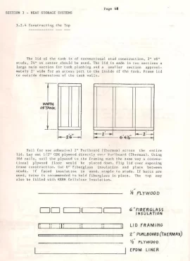

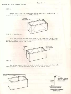

It has been recommended that pressure treated lumber be used,and stainless steel fasteners .
Also today there are much better liners than EPDM , and I'm sure the company that I linked above would put you onto them.

Build your own tank/frame and then get the liner from Tom, that would keep the shipping down.
What are you going to be using for exchangers?

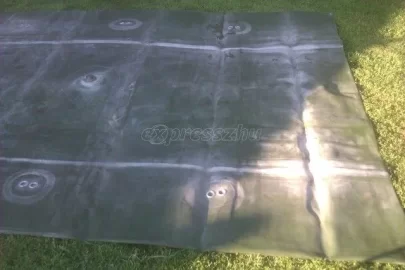

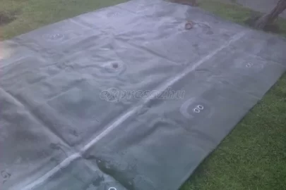

What do you guys think of a rubber tank? This is german made and 4600 litres so 1215 us gallons

Most "rubber" tanks are synthetic and few are rated for high temperature. From personal experience even tanks rated for high temperature occasionally fail. There is a lot to be said for a welded PVC liner rated for the appropriate temperature. Unfortunately it may be hard to get in Europe as PVC is generally not recycleable.
