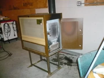

Its not really a furnace, although Newmac does make furnaces. Here is a picture. Its kinda like a wonderwood us stove

A firebrick lined 30 gallon double barreled stove with secondary burn tubing loop will get you crazy long burn times and heat that shop in no time. Even a single barrel will probably do ya fine.
I've used a 55 gallon setup for years and it looks to have many more left in it. Cost me about $200.00 including $20.00 to have the local metal guy cut the holes and $40.00 in firebrick to build it right. Took a couple hours to put it together. I've recently installed a primary air baffle on the bottom to get more O2 to the rear of the stove to fill out the flame plume. Really helps prevent coal build up as well.
Not the cuddliest looking heater one could want, but it sure does the trick very well. I inspect mine for metal fatigue every season, and in four years I've yet to find any.
TS
I like Techstuf's idea for this application, along with 2 or 3 ceiling fans. Rick
The was a like-new barrel-heater I took out, for insurance reasons. I have to have a CSA/ULC etc rated appliance for insurance or yeah, barrel heater would be great.
