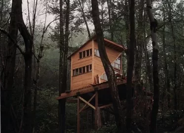

Hiya,
Just wanted a general opinion of the best stove (or other) to heat my 100 sq ft treehouse. It's 8' x 12', 13' tall with a sleeping loft a lots of glass and no insulation (yet?). For electric is has a small solar panel and a deep cycle battery. It's in the catskill mountains so it gets pretty cold but I'm not sure I'd sleep in it in the dead of winter with the wind and all. I want an efficient little stove that's safe. Any suggestions would be greatly appreciated.
Thanks,
Lulu

i'll be honest , i do not know if there is even a guideline for what could be used in that application, (neat looking house though i think its kool!) pellet is likely out due to power constraints, so wood would be alternative, gas doesnt seem feasable , but may be doable, although the tank would have to be on the ground. maybe elk or sombody might know if there is a guideline for a woodstove in a tree house. i dunno where to go with this. would also be interesting to know what the flue requirements would be , especially with the trees surrounding the home the way they do. wish i could be more helpful, hopefully sombody in here will be able to advise you better than i can.
EDIT: is it actually built in a tree or on stilts anchored in the ground , cant really tell from the picture but that would be important to know
Yes, it is indeed a toughie seeing as though the structure itself isn't legal. The house and deck sit on top (unattached) three beams that are mounted by GL (it's specific to treehouse building) brackets to each tree. The stilts (5 of them) are there as added support to the beams though they aren't attached. Essentially everything is touching. Think suspension system.
The deck, however, is 150 sq ft so it may be possible to route the chimney out a way that would leave the trees unscathed. The largest distance between trees is 25'.

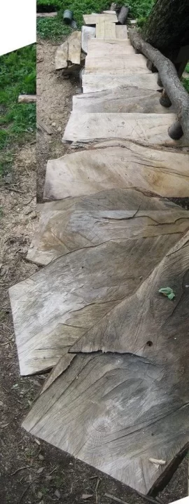

and as for how i get things up to that deck:
