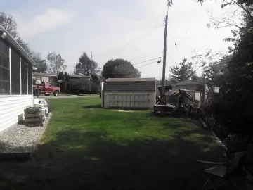

I enclosed the porch of our 5K fixed up retirement home. Last year the park eliminated wood stoves because of one homeowner who smoked out the whole park. He tentatively okayed a corn/pellet option with the requirement that if he gets complaints it goes. I switched to propane last year and installed a 95+ furnace. I kept the house at 70 but we were both cold and would love to have a coal/wood stove but not happening here.
The porch I fixed up has Florida windows and a screen door. I was able to put r-13 in the walls and ceiling which will be finished wit a drop ceiling. By 10 or after it gets to 80 and up but cools when the sun goes down as no heat is there. I would love to sit by a warm stove and let the heat in the house. Do pellets stoves get warm. I have a 20k blue flame in the LR for back-up when the power is lost. I'm retied on a fixed income so I would like to get the best money spent route. Corn/pellet or another blue flame. I pay $2-3 per gallon of propane and used $400-500 last year in a somewhat mild winter. Give an old timer some advice..The one pic is the back wall. I would like to put the stove in the outside corner of the back wall so the direct vent is hidden. The other pic shows how far the other homes are away

Thanks for at the comments. The porch is 20 x 9 and the ceiling goes from 8-9.5 ft. I would like to heat it during the winter. I thought about covering the inside Florida windows with the inside storm window plastic that you finish with a hair dryer. I wasn't sure about coal smoke/odor although I grew up tending a coal motorstoker and inhaled a lot of coal and ash dust. The coal was like a 1/2 or so pieces. The flue went into a chimney so I never noticed the smoke or particulate matter. I,m trying not to go over $1500 so that might limit me. I imagine the propane woodstove like stoves are very inefficient. This is less than a mile away:
