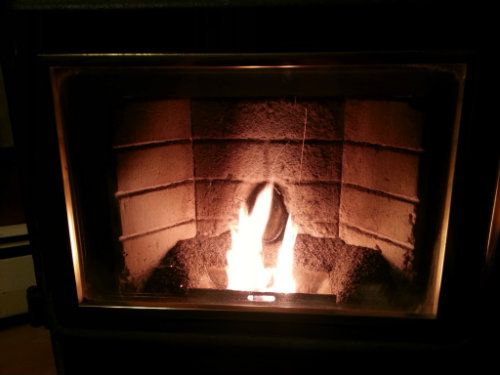

Been lurking here for a bit and have already learned many things about pellet stoves and how they work, signed up to give a big thanks for all the info here and to share my experience with my first stove. On the advice of a local dealer i bought a whitfield, saw it running before i bought it, dragged it home and set it up with 3" pipe according to the specs in the manual. The adjustments for pellet feed (all the way down) and combustion air (turned all the way up) must have been a lame attempt to keep it running, as it was stuffed with so much ash i had to pry it out with a screw driver. Cleaned per manual and it looked like a different stove. Bought a few different brands of pellets to try from HD and found that stove chow produced the best with constant 161 degrees of heat out the tubes on lowest setting, 275+ degrees on high. Bought 2 ton of it, loaded up the hopper, used the info i learned here to set it up and get it running like it should be. I love it, stare at it all day, search the internet for pellet prices, i am hooked after 1 week of burning. :p Air and pellet adjustments are now back to factory settings, heat is fantastic, keeps my 1,200sf home at a cozy 74 degree average, oil furnace has been off for a week. Did my first 5 day clean out today and found out that if you put the burn pot in backwards and start it, it will fill the house with smoke quicker than you can say "oh sh**" lesson learned, noob mistake! Guess a new door gasket is next to do.
Question i have about the ash build up surrounding the fire pot, is this normal, should i clean this area out daily along with the ash pan? Picture is after 3 days running on low.

This pellet stove thing is my new drug too. Don't worry about the ash...I clean my stove every 3 to 5 days to take care of the ash. What does the rest of the setup look like?
There has to be a co-realation to owning a pellet stove and OCD. I clean mine once a week weather it needs it or not.
Just check the burn pot and if it starts filling up on the sides inside the burn pot it is time to clean it all out.
Several pictures on the forum of the ash piled up to the rear, both sides and half way up the door glass with a nice clean burn and a clean burn pot.
I can't stand to look at that after awhile and just have to clean it.

Thanks for the help, couldnt stand seeing the ash build up and just sit there so i used a long handled spoon to scoop most of it out.
Stove is burning great, ordered a powersmith vac for the next clean out
