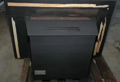

No adapter, The outlet looks like this...

Draft is the engine that drives the entire stove/burning/combustion system. Draft is caused by the warm air in the flue rising, which pulls cooler room air into the firebox for combustion. If you have a sluggish draft, you can have lazy burns or even a house filled with smoke every time you open the door on the stove. Draft is a, if not THE, key element in having a well functioning system. (Draft and dry, seasoned wood.)
Most stoves are designed to function with X size exhaust. If you vent the stove into a larger opening than X, you can cause sluggish draft because the exhaust cools and slow as it expands to fill too large of an area.
This can also cause more creosote buildup in the flue. Cool flue gases combine with water vapor and unburned organic compounds to form the dreaded creosote.

Oh yea, I forgot to add, my place is only 1400sq ft and this will be supplemental to my baseboard heat. Out climate here is mild, it only drops below freezing a few times during the winter but I will be burning often, maybe not 24/7 but definitely every night. Our chimney is in the middle of the house so its ideal.
Any ideas on how to adapt the rectangle to the pipe w/out dropping $150?
Is this a non-cat Squire for sure? They did make a cat model.
The best suggestion would be to get a new cat insert like a Buck 20 that is sized for the place and install it with a full 6" liner. That will totally qualify for the tax credit and will give you years of predictable, clean burning.
Making the old Squire work will have some of the same costs, but higher for the 8" liner. Whatever you decide, have the chimney cleaned and inspected first.
