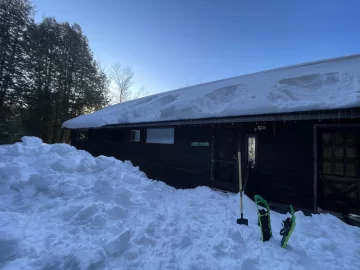

So we put a steel roof on two years ago or so (time flies), I replaced our metal shroud with the silicone boot provided by the manufacturer. First season was fine, but likely some damage from sliding snow has caused a very small leak in a very specific place. I think I have given up trying to fix it, and want to move on to replacing the boot with something like we had before (all metal).
I can't remember the exact size of the stove pipe, but would something like I have linked work if I get the right size?
I will make a separate post about snow proofing as that is another battle in my mind, I may also take one last stab at the leak.
Work in progress pic so you can see what we have going on, and the amount of snow I am dealing with.

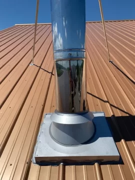

Consider getting a boot flashing made for metal roofs like the Excel model. It gets notched on the bottom to clear the seam ridges.

Personally, I would not install the silicone boot. Just look at the number of screws (ie holes) it needs to hold down. The Excel flashing is stainless. It requires about six screws. Properly installed, it will last as long as the chimney pipe, maybe longer.
Yes! The part I ordered is Excel 6EMFA (the "6" just indicates the chimney ID) which appears to match the one in your images above. It's the only one I've found that comes with the raised lower edge and it seems to have the best reputation here and elsewhere I've researched.
