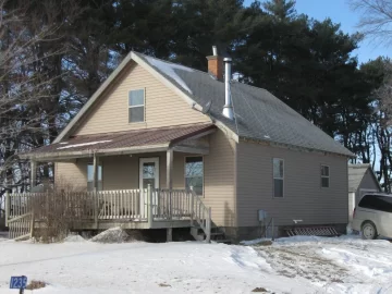

Anyway I am located in NE Iowa in the country, on a small acreage partially surrounded by a very nice timber wind break (north side and west side). Story and a half home that arrived as a package deal on the local railroad in the mid 50's. Complements of Sears!

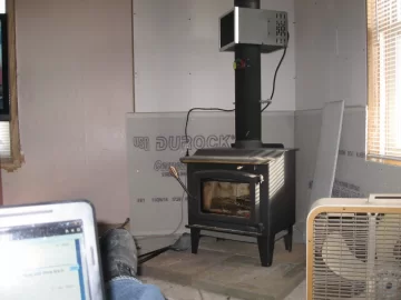

Started the stove on the the 2nd of this month. Left the LP turned on for a few days and it ran one or two mornings until I figured out how to babysit the wood stove a bit closer. The last handful of days the LP has been turned off. I am layed off so I can keep a close eye on things. Only problem has been the severe cold/wind we have been getting. Still has kept up without to much effort. This morning was -16F and I had let the fire go un-attended for 4 hrs. House was at 60F when I woke up at 2 AM. Took a few hrs to get back up to 65f! Not a big deal except I have the stove on the main floor. Basement (where my shower is!) is really cold. This afternoon the house is cooking;lol
Hears a pic or two of my 23 year project house! Pulled the asbetos siding and installed new windows, Aluminum coated 5/8" foam insulation board and vinyl siding. Huge difference. Zero insulation in the entire house. Unreal. Just started the remodeling a year ago. Lots to do. The stove is installed temporarily at this point as I need to pull all the punkboard to insulate/rewire and sheetrock. Yea. Fun.

What a beautiful little house. Great story.
That is unreal, zero insulation in 1950. We have certainly come a long way.
I have a Defender, I like it. It's a decent little stove for the money, even more so at the price you paid!
Vogelzang has/had a bad name from the junk that they made in the past. The Defender is a big step away from their past IMO
I see you have a key damper in the pipe, I have been thinking I need to do that because the Defender seems to be a pretty easy breather. I blocked some intake holes to slow the burn down, it works really well like this. I think if I had a key damper I could unblock the holes and it would be fine.
That heat reclaimer on the stack may cause you trouble though. They are known to cause creosote issues in the pipe, you'll know when the pipe plugs up (or the unit plugs up itself), the stove will blow smoke in your face whenever you open the door. It would be easy enough to remove if it does prove problematic for you
Good deal, but get rid of that stack robber on the pipe. EPA stoves are more efficient and run cooler flues. Cooling them down too much can increase creosote and ruin draft. The stove is for heating, the flue for drafting.

Welcome moresnow, I knew that heat reclaimer would draw fire ;lol.
We shall see on the reclaimer.This stove really likes to run harder than I prefer. Dampers fully closed on the stove and the pipe damper fully closed seems about the only way to keep it slowed up. Lighter wood loads on the real dry wood is plenty. Otherwise it gets sketchy. I will have a look for buildup in the next few days. Supposed to warm up finally.
