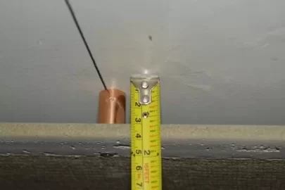

i seen a guy on here use copper pipe with washer, that might be somthing to consider as spacers.

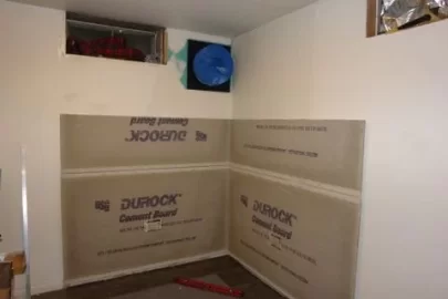

I used durock with copper spacers.
