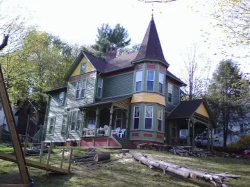

A little bigger and little newer than yours - 1885 Victorian. ~2400 sq ft w/ marginal insulation (did the roof nicely before finishing the attic, and the walls have blown-in) plus about half new windows. Pic attached. The Heritage definitely doesn't overpower, BUT... This is new to me - we just installed a month ago, and we've got the Wet Wood Woes, so anything much past 425 F stovetop temp is a bit foreign thus far...
We plan to burn more or less 24/7 once the cold stuff really hits. Looking forward to NOT running the oil-fired boiler for the single-pipe steam radiators unless absolutely necessary... I'm in Stafford Springs - PM me if you wanna see it in action. Pretty warm today so wasn't planning to fire up, but I could be convinced ;-P

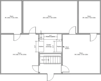

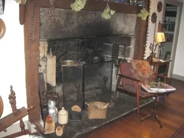

Here is a word document that contains a layout of my first floor. The fireplace the stove is going in is 4' wide, 41" tall and 2' deep. There is a 21" hearth stone in front of fireplace opening. I also attached two pictures of the room where the stove is going. I'm going to sell the Franklin stove that was there.
The ceiling height is 7.5 feet tall.

Great pics, that helps a lot. This is a challenge due to the nearby combustibles. The Alderlea may be a good bet with its close clearances.
The layout of the house is not the most conducive to good central heating. I'm guessing that originally they closed off rooms they weren't using and only lit a fire in them when company came. This fireplace would mostly be just a room/area heater in which case the T4 might work. From the looks of it, the kitchen fireplace holds the most promise for locating a larger, stove for better heating.
When I look at the specs which number tells me the distance to the mantel (top clearance) that I need? I think that I'm fine to the rear and sides.
Thanks
Ed
That's the problem. There isn't a spec for the clearance to mantel. I'm not sure they tested for this, but suspect not.

- Do you have a plate inside the top of the firebox to go along with that liner? Or is it just hanging there?

First...the pic of that house is way bitchin'!!!. Looks tough to heat but a neat looking house.
Second, I don't have any specs on the proper distance to the mantel....but my stove pipe goes into my hearth wall less than two feed below my mantel. It's a doozer of a mantel (solid oak) but i've been burning with it that way for 8 years with no problem (for the record, some A-hole didn't have this much reference into when he built his house so he just went with it :sick: )
Looks too Gothic to me... How do you sleep with the ghosts roaming about? Just wondering :roll:

Ed, that is a beautiful home!
Thanks for the kind words - the house is truly a labor of love. We fell in love with it the moment we first saw it. And yes the house is tough to heat. We've been here 10 years heating exclusively w/ oil (single pipe steam radiators). In the depth of the cold season (Dec-Feb) we get 200 gal fillups like every 3 weeks!! Incredibly inefficient.
We based the decision on the Heritage (with its significantly high up-front cost) partially on the payback from NOT buying that much oil - estimating we could at least pare 50% off last year's oil purchases, and it'd sorta pay for itself in a few years... If experiences thus far are any indication, we should be able to top that estimate. My goal now is to simply stretch the oil tank (just filled up w/ 150 gal @ 2.609/gal) as far as we can. If it goes to Christmas, I'll be tickled. We do expect we'll need the oil to fire on every now and again - esp in the mornings just to warm up the place while we get ready for school/work. And I'm more than a little concerned about possibly freezing the watermain without the boiler spilling so much heat out into the basement space...

Our layout is similar to yours except the stairs were moved to the opposite side (taking up some of what would be the righthand side of your large room). In our house the location where your stove will be is the largest fireplace, and we also have a one-story on-slab addition across from that fireplace, so it was central and the best option. We don't expect the opposite room (upper left) to ever get very warm, and I'd guess neither should you.
How much heat are you hoping for upstairs? It looks like the stairway opens on the opposite side of the house, so that could present a problem getting heat up. Because of our stairway location and header, our upstairs gets warm so fast we need to close the door. Another thread mentioned door headers being a big factor to warm air flow. I had never noticed it before, but our stairway has the highest doorway opening, so the warm air just shoots right up.

From what I see, the two big challenges here are the large opening which is entirely surrounded by wood. That creates issue #1 - clearance to combustibles. Issue #2 here is size. This is a closed floor plan. The best place for a big stove appears to be the large kitchen fireplace. A large stove in this little room (196 sq ft.), is not going to work well. For a freestanding stove to work it is going to have to fit entirely within the fireplace to avoid clearances issues. But that will reduce the heating efficiency unless the stove has a blower.
Within these constraints, I see this location as needing a front loading, top vent stove, under 2 cu ft. that runs well with a partial load of wood, has a blower option and looks appropriate for the setting. That's how I came up with the T4. It's 20" depth will fit entirely within the fireplace and it has a blower option. Another stove to look at would be the Hearthstone Craftsbury or perhaps the Tribute?
I was looking at the floor plan and thinking about air flow and didn't even look at the pics - all that wood is a big problem. I would consider the other two fireplaces depending on their surrounds. As Bigg Redd said, maybe two is the way to go.

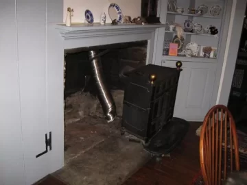

Ed asked if the stove pipe just hangs in the flue or if I have a plate there. There is some old sheetmetal that I have from the old Franklin that I'll be using and adjusting since it is nicely formed (my neighbor made it for the previous owner when he had a heating business with all the sheet metal equipment)
I am going to take the advice I got and put the the stove back in the firebox with a blower. Since the house is small, this will give me a little more floor space and keep me from using it as a shelf for clutter during the non heating season.
Someone asked about a fireplace insert or two. I guess that making the custom front plates would be pretty expensive and kill the charm of the old fireplaces. Anyway it is sort of fun to think about all those wasted energy $ floating up the 200+ year old chimney (just kidding). The house isn't that expensive to heat since it is small and we keep it cool. It has steam heat which is another adventure. My same heating neighbor says I should switch to hot water but I like the steam for now.
It was also suggested that I put the stove in the larger fireplace. I don't think my wife would go for it because that is where we roast most of our pinecones (they are in the pots in the attached picture in case you can't see) :) I'm not a big fan of that location since I'm almost done on the roof and I'd hate to have to break the motar away and remove the large piece of ganite (countertop grade) that I installed to replace the broken up concrete cap. It is 42" X 42" and I have a 45 degree pitch roof so getting it up there took an ariel lift and staging and a friends time. I almost done with the final stages of the chimney repair (the stones above the roof line were pretty loose).

Great looking fireplace. I suspected it would be massive. With a big Alderlea in there your wife could roast pinecones to her heart's delight. The trivet top gives lots of control over the temps and is ideal for slow roasting. There should be no mods to the top of the chimney, just another 6" liner. But I can respect your desire to stay off the roof.
I have an 1820 cape with exact same set up. We put our Olso in the back room given that it is more centrally located. With small fans, I can easily draw the warm air into the front rooms. My house is a bit bigger, but have no problems heating the downstairs. I do have a tough time heating the upstairs given the multiple doorways and the very small and tight staircase. Still thinking about how to get the heat upstairs.
I also have wood surrounding my fireplace. Unfortunately, I had to remove the mantle and cut back some of the wood above the fireplace. The clearance for my stove was 30". If you go with a stove, it looks like you will also need a new hearth / hearth pad. But this of course all depends on what stove you put in. If you go with an insert, then it sounds like you can avoid some of the clearance issues.
I would consider putting the stove in that back room.
Just curious - do you use your third fireplace much? I was amazed at how much heat was shooting out the top of my unused flues, even with dampers closed. I decided to seal off the flue top of our third and smallest fireplace.
