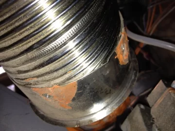

New to forum. I have a Saranac pellet stove insert and am having a hard time disconnecting the 4" flex chimney liner. It's direct connected to the blower on the back of the stove and has (4) screws which I have removed. It's a tight spot in the fireplace, but I cannot get it to budge. It shouldn't be this hard to disconnect...Anyone have any experience with these stoves?

looks like it rusted itself together. pull, pry, maybe try some pblaster (but be sure to clean up after so you don't get any fuel fire in the chimney)
Looks to me like it was sealed with silicone caulk. Makes'em dang near impossible to get apart.
The collar should come off with the pipe.
Looks like its siliconed in there well. Can you carefully cut the collar down the middle with a dremel tool in a few areas to pry it off?
You could try to twist the collar loose with a strap wrench.
Looks like high temp copper silicone was used - it will come off, but as posted above, best to get a rubber strap wrench on it if you have to room to work.
Thanks all for your comments/suggestions. It's incredibly tight in the fireplace so not much room to work. Talked to Hudson River Stoves and they said its normally sealed with silicone. Thought about removing the collar adapter (connected to the blower), but there is one screw that is virtually impossible to reach. I may try to heat up the collar and see if it comes free.
