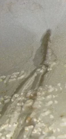

I know this is not directly related to wood boilers but I do trust the information I receive here so I thought I would ask. My son just called a few minutes ago and said his Utica ub90-200 natural gas boiler with a cast aluminum heat exchanger is leaking through two pin holes. I would like to get some possible directions to help him with this problem. I am driving to his house today and will check responses along the way when possible to get an internet connection.
Does this mean that the boiler is trash?
Is it cost effective to replace the heat exchanger or is it usually best to replace the whole boiler?
Can it be repaired by welding or another method?
Do any of the liquid weld patches work? If so which ones, even if only a non-permanent short term repair to buy him some time to find a good permanent solution.
It is a 2005 model and possibly would have a part only warranty coverage.
Thanks, George

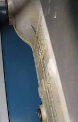

I'd like to see pictures of the block if you can get some. Mainly the location of the pinholes. I work with a chemical blender that formulates cleaners, inhibitors, and glycols specifically for aluminum block boilers. I built him a heated coupon rack to test the various fluids in the market place. I've seen samples of what "off ph" fluid can do to aluminum in a very short period of time.

  • [Hearth.com] Help--cast aluminum heat exchanger is leaking through two pin holes

My son will check with his concrete contractors and the Utica distributor tomorrow. When I looked at the leak last night, the stream looked like a cobweb when the circulator was running.
a small punch can sometimes "peen" a pinhole shut. Check with Utica before you add sealers, it may void the warranty. if it has thin casting areas, you will want a new HX. The HX should have a 10 year or longer warranty?
