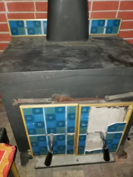

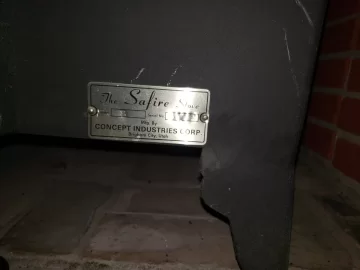

Hi I was wondering if anyone could help me find out the UL rating information for this stove. From what I have found out is that the company is no longer in business. I am trying to get this information so that my insurance company will insure my home with it attached.

If there is no ul tag on it legally it is unlisted regardless of whether it was when made or not. And it is very likely it was never listed
So do you know what I could provide to the insurance company so that I can get the home insured
If they require the stove to be a listed stove you will have to remove it. If they just want to be sure it is installed safely an inspection report showing it is installed to nfpa standards for unlisted stoves should be enough.
Some companies simply will not write a policy for a home with an unlisted stove though.
