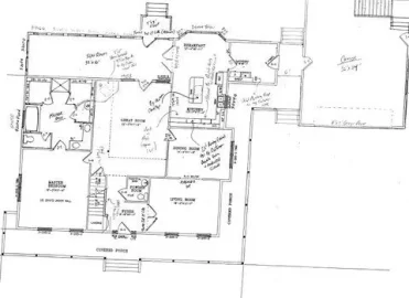

The room the stove will be in (installed in a corner) has a 3 ft. ledge all around the room with 9” ceilings. The room its self is 22’-2” x 17’-2”. The rest of the room is vaulted and open for about 3 stories. This area is also open to a kitchen and dining nook besides the upper story. I have tried to attach approximate floor plans; we have made some changes but the changes just increase the sq. footage.
I love both the Jotul 500 and the 600 in the blue/black enamel. My main fear is buying too much stove and burning the place down! Any advice and suggestions from those more experienced would be greatly appreciated.

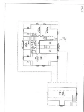

I believe I got the floor plans attached this time; thanks for the tips. I don't really know the square footage of the 1st floor, but as you can see, there is a large area to heat, especially with the vaulted area. And while this stove will be mostly for chill chasing and ambiance, we can and do have periods of power outages when we would like to use it for heat and cooking.

Thanks for posting the plans. That looks like a good place for the stove. I think you will be alright using a 1.5-2 cu ft stove. In the event of a power outage, it may not be that efficient but not because of the stove size. The big issue is going to be heat pocketing at the top of the vaulted ceiling. During an outage, with no power for ceiling fans, this will be worse. If the power goes out for an extended period, I'd close off the sunroom, dining and living rooms and focus on heating the central great room, master br, and kitchen areas.
Thanks, I am getting really great ideas and info here.
We had actually thought about closing off the master bedroom in the case of a power outage, opening one bedroom upstairs and sleeping there.
Due to the plumbing, I'd leave the masterbr door open if temps are below freezing for an extended period of time during the outage.
