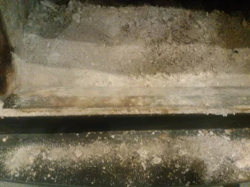

Can someone take a pic of the airshield inlet at the front interior of their FP30 for me please...I need this asap.
Buddy of mine cleaned out my fireplace and I think he put it in backwards. Theres a gap once you open the door. I dont recall that gap. I also thought the piece had some holes on the top but I dont see them..... I have a full load in now
Thanks guys
Actually it might not be that piece... its the front steel piece on the bottom of the firebox that covers where the air comes into the firebox. Bent 3 inch piece of steel that covers it....
Sounds like the boost air manifold cover. If so, the holes face inward, toward the base of the fire.
Only if you stick your head in the firebox and look backwards toward the front lip.
Holes face inwards...... towards firebox
