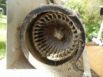

In the video the sound got louder as you went around towards the back of the stove on the right side facing the stove. T hat is where the distribution fan housing is located. It's an open squirrel cage fan. Anything can get in touch here, from dropped pellets to a mouse. Cat hair, you name it. As stated, clean everything, including all that.
Removal of the distribution fan is fairly easy. Two 7/16 headed bolts, but will need a socket on a extension to get at the inner one. The fan fins really build up some dirt and dust bunnies
WOW!!!
Just checked mine today and barely any dirt at all...
last check year ago..didn't look any different..
WOW!!!
Yeah mines never been that bad LOL !! Usually some fine cat fuzz on the fan blades. But it's an open fan so anything can get in there.
