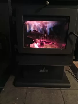

It's a cheap one. Master Forge from Lowe's. Glass looks cracked in the pic but it's not. I think the model is WS110.

Looks like a good secondary burn going there. You'll find that as soon as the fire is burning well, turning down the air as soon as possible without killing the fire is the best way to avoid a too hot stove. Reload with thick, dry splits packed tightly.
Reactions: ctreitzell
The secondaries on this are amazing. I have no experience with this type but can only compare it to a Woodstock fire view cat stove I had years ago. The secondaries on this stove burn nearly as long as that cat stove. That surprised me. I thought it would only last about 20 minutes or so but it went for a couple of hours like that. Maybe longer I had to take off.
