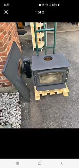

Can anyone tell me what brand this is? Just picked it up and it has no tags or markings. Thankd

Looks a bit like a Regency R14. What does it look like inside the firebox? How many secondary tubes?
It looks like it needs more than just firebricks. The stove has been neglected. The baffle is missing and the front air wash diverter is burnt out. Are there any cracks around the door opening?
