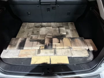

Yes I did, but have not installed them yet. I want to clean all that creosote out first. They were kind of yellowish pink in color. Never saw any firebricks other than off white. Hope they can handle the heat

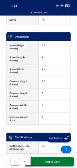

Lowes dimensions diagram is in error, the product listing says 9" x 4". Will conventional 9"x4.5"x1.25" fire bricks work?
Reactions: Burnin Since 1991
2 thoughts you can cut them to fit with an angle grinder or get the ones begreen said.
If you cut to fit it will only be a couple. Should be easy enough to do. Or a a masonry blade on a circular saw will work too.

Even Lowe’s specifications section is wrong. Lesson learned. I could use the thinner bricks and just cut 1/4” inch of the ends of a row of bricks

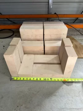

Looks like I’ll be returning my bricks to Lowe’s. Saw an add for 38 for $25 and grabbed. Also included 11 half bricks. The measure 9x4.5x1 3/8, haven’t confirmed their measurements yet. So now I need to figure out how these will fit in my 18x32 stove

That's a decent score. With the bricks properly configured I would think it possible to load quite a bit of wood in the firebox with at least 24" long splits. Try with two full bricks laid E/W on the firebox floor for a load width of 18".
Only problem with that is there is nothing to hold up the side bricks. Unless I don’t need them or just do without. I did measure them and they are 1 1/4 not 1 3/8 as advertised.
I could use my Lowe’s bricks on sides and back and use smaller bricks on the bottom. Then everything would be locked in. Or is there a a heat resistant adhesive I could use to hold them up to the sides?
They may be held up in their 9" vertical position by the floor bricks wedged against their base? If not, a top rail could be welded or bolted in. If that is done, keep it loose.
