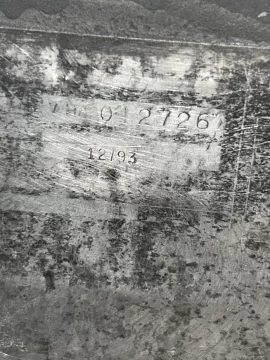

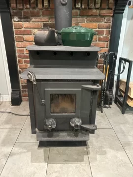

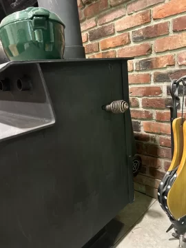

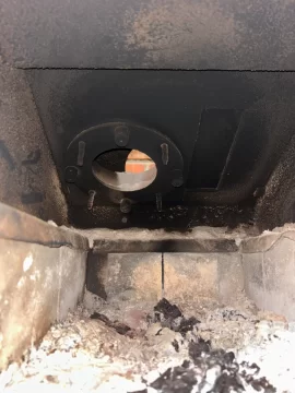

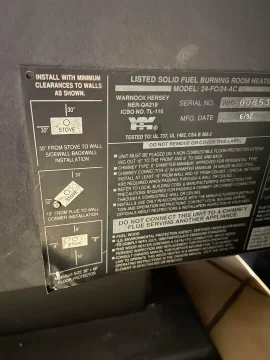

I have an englander wood stove that i purchased not knowing it was. missing the cat and the impingement plate. I have been using it for a few years and it chews through the fire wood and doesn’t keep a fire going over night very often. I’m looking to identify what model it is so I can order these two parts in hopes it will increase my burn time they have included a few pictures of the stove, including the tag on the side. Most of the information is unreadable minus the date that is 12 of 1993.

It looks like an Englander 24-FC or 24-AC.
