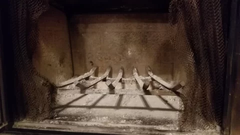

Hi experts. I have a fireplace that one pane of glass broke. I'm trying to identify it to see if I should fix it or upgrade to a more efficient ZC Fireplace.
I know it is a Superior, as the fan has the markings: " FAK 1500 for use with models HC-3320, HC-3820, HC-4320, M-3350, M-3858, M-3355, M-3855, 38B" . I found two aluminum tags on the sides, but they seem to only have warnings. They are barely readable due to sooth and cleaning them up just erased what was written on it.
Anyway, attached are some pictures of the fireplace if somebody has any idea of what model it is.
Thanks for all the help.

Those are Superior Fire Place Model numbers...
Look for a rating plate behind the screen on one side of the opening.
Maybe there is one there.
In your pic, the FAK usually designates a Fresh Air Kit, & the models
that it can be used on, are cited after that kit number...
If Superior follows other manufacturers examples,
those numbers refer to the height & the width of the opening of the firebox.
Measure the opening & see if ANY of those numbers are applicable...
