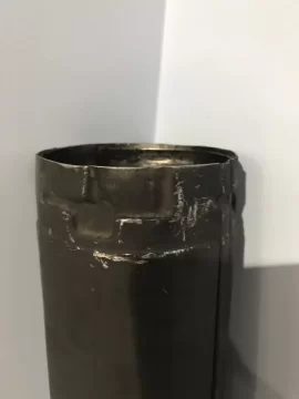

Does anyone recognize this pellet stove flue pipe? I can’t seem to track down the brand. My new pellet stove connection is about 4” lower than the last one. I’m not sure if I replace a whole section, if they sell a 4” piece or if I should just make a little platform for the stove to elevate it to the right height. Any suggestions? Thank you!!!

best to go with the raised hearth option, new piece of pipe is not gonna help with the height difference

They make an adjustable pipe section . Most pellet pipe companys have this in stock .
You might want to look this up. DURA -VENT 1FOOT ADJUSTABLE 3 INCH PELLET PIPE . Englander stoves . PT NUMBER AC3012A
Looks like the old style duravent,was discontinued a while back,does not mate/seal well with the updated stuff.
