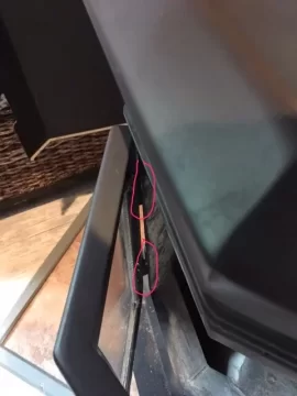

Thanks for the replies. I will get a new gasket suggested and try it. I did notice something else after I posted the request for help. When I close the door without the gasket I see that the top part of the door is closer to the frame than the bottom and when measuring the distance I find that the top is indeed about 1/8" closer and is the first part of the door/gasket to make contact.There doesn't seem to be a way to adjust this plate where the door pin is located other than prying the piece of metal with a flat head screw driver or similar tool. Not sure if 1/8" difference would cause the issue but when I examined the gasket that is where is see the indentation mark. If that is indeed the cause is there a better method to create equal space between hinge pins and the stove frame?

With any door gasket you need to dry fit it first... you can pull or compress the rope to make it thicker or thinner. I had the same issue with my big e i had made the gasket to tight. 2nd try i dry fit and adjusted till door fit tight but closable and no gaps. Then i tood it out and glued it.
