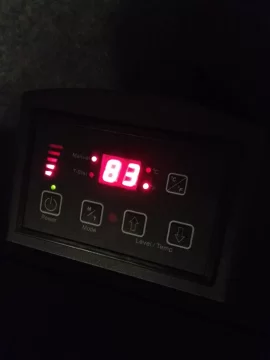

you can not install a thermostat, there is no connection block / point on the board.
  • [Hearth.com] Help installing Thermostat for Ashley 5660
The AP5660 has a built in T-Stat and the sensor probe sticks out the back.

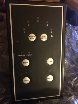

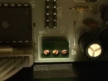

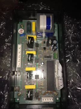

Don,
The older ones don't have this board, they have the older board that has feed trim etc, as does the US Stove 5660, but the newer ones from 2013 onwards use the new board that's in my post above.
You should know this yourself based on a post you made back in 2012.
https://www.hearth.com/talk/threads/the-most-confusing-pellet-stove-specs-on-the-market-today.87517/
I did not say the AP5660 was your stove, just the fact it has a built in T-Stat and maybe you could upgrade to this board.
If you have the board in my pics below, the tstat connects to the screw terminals. It also shows them in the owner's manual.
