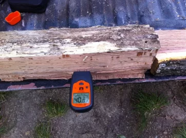

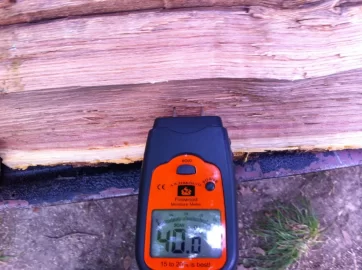

well the wood we chopped is dead but it was still standing. it's not fresh wet wood. i heard that was the best kind ( the dead, still standing) ?? you guys are awesome for your input by the way , Thanks!
Here is an example of standing dead wood compared with a tree that still had leaves.
[Hearth.com] HELP!!! Lennox canyon vs. Lopi Cape Cod standing dead for at least 5 years.
