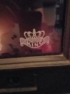

I am trying to find information on my stove. All identifying information I can find is there is a sticker on the front with the word king and a crown. And the side shows a model number of KIG28. I can not find any information online. Can someone point me to the right manufacturer? Thanks in advance!

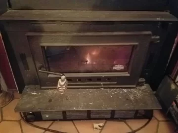

Pics of the stove and a close up of the sticker would be helpful;) Welcome to the forum!

My primary issue is finding where the combustible air intake is fed. I am in the process of converting it from a "slammer" install to piped into the existing liner. Burns well with little smoke when door open. And tends to immediately smother when door shut. The only air intake I can find is on the door there is a slide gate. Unless it is fed by the blower but can't find any additional holes in the fire box. I have a heck of a time maintaining a good hot coal bed. After burning there is very little ash left.

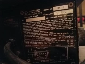

Martin Industries was the manufacturer but not finding much on line but they were bought out ... track down the new owners to see what they have as they purchased "intellectual property" That's why I asked for a pic of the label as it's on there...

Most likely that front air control is the only source of combustion air.
