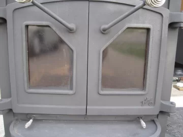

Grandpa IV with glass;
IV GP Georgia Front.JPG Georgia Grandpa IV
Many more Grandma's in circulation compared to Grandpa with glass;
IV Nickel.jpg California reconditioned Grandma. Notice the doors come out to the stove edge. Grandpa has some stove front showing.
This is how you can tell in a picture what it is when the seller has no idea.

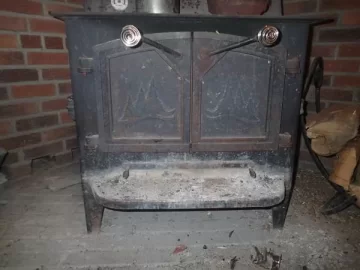

Cast iron panels were also an option in case of glass breakage and radiate more heat;
Grandpa IV Glass w cast inserts Century 1.jpg Grandpa IV with cast iron panels.
IV cast iron door panels 1.jpg IV cast iron door panels 2.jpg I don't have one, so I can't tell you if they use the same doors or if the doors on Grandpa are larger than Grandma. The solid doors are larger on Grandpa I, not sure about the glass doors. And I've never seen a Grandpa III with the smaller glass opening.

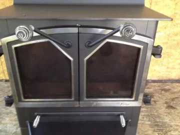

Glass shape of Series III Grandma, Insert, and Honey Bear;
GM III Ind. 2.jpg If a Grandpa door like this exists I've never seen one. I'll search brochures of that time period. Each fabricator didn't have to make each model. So there were some models never made at some fabricators. So literature doesn't mean they were produced. Still looking for a brass XL I have the brochure for. They have only surfaced with nickel in the sun door.

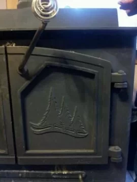

Clancey-thank you. I do plan on painting the trees and the "Fisher" silver this summer, but just needed to get heat back in my workspace. Once it warms up in a few weeks, I'll be able to do that. It's still in the 20's here at night.......
