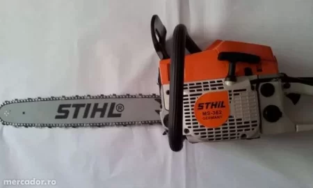

Mike is being a twerp. An MS362 is not in the OP's budget.
Reactions: D8Chumley
I recognized that he picked a higher priced saw. But I was optimistic thinking that a saw like that was in the budget the OP was trying to stay.-LOL I was disappointed again when I did not see MSRP on the Stihl line.
The 362 is $700+
