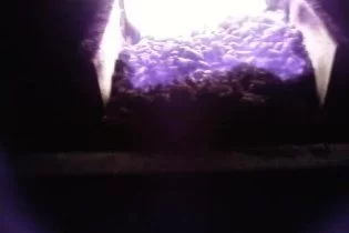

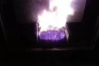

I am getting a little frustrated with this. I am having a bunch of unburnt pellets build up in my burnpot causing me to need to bring the feed down to nothing and mix to burn off when they stack up. The flame burns mostly at the back of the burnpot so once the pellets are pushed further up (by horizontal auger) they stop burning and pile up. Currently I am running on medium to hhigh settings so the bottom three buttons (air and feed adjustments) do not come into play. I don't believe it to be the pellets it has happened on both brands I have burned recently. I am currently burning Okanagans which for the record to not smell like a dead animal or cat piss:)
I just recently did a good cleaning: scraped vent pipes and did the leaf blower trick and vacumed out the inside, scrapped the walls and behind the baffleplate. Problem occcured before and after the cleaning. The stoves is new and has only burned about 60 bags.
Any ideas?

Joe, has the stove burned like this since it was new?
Can you describe your vent set-up (length, number of elbows, type of install, etc, etc)?
Did you remove the combustion blower during your cleaning to make sure it isn't caked-up with burned-on ash & soot?
In general, it sounds like a lack of burn air.

Vent: out the back 6 inches, t with 90 degree elbow, 3 feet horizontal direct vent. OAK is hooked up.
I didn't remove the combustion blower. Not exactly sure how to do it. Can I do it without removing my vent piping and exactly where should I be cleaning?
Wouldn't think this would be an issue this quick but I'll give it a shot. I'll check the video maybe they show it. I am getting exaust air outside (I could see the heat radiating out this morning as it was freezing out).
How exactly does the exaust and burn air go together? What blows the burn air to the burnpot? I was trying to figure out if I was getting an blowing but couldn't find a good way without sticking my hands in the fire.
I'm not too sure if I've had this issue since new or not. I was burning mostly on low with cheap pellets. Lots of clunkers. I did burn 3 bags each of Spruce Point and Okies about a month ago. I don't remember if this occured or not. I was hoping it was an issue with the other pellets but it did not get better when I switched. Am getting more heat though.
Well, first of all, Englander recommends in the install manual that you have a minimum of 3' of vertical rise, which you don't have, but i don't think that's the problem.
Removing the combustion blower isn't hard, and the exhaust pipe does not have to be removed. It's behind the RS (left side facing the stove) access panel. Disconnect power first, unplug motor leads, remove nuts around blower. Try to be careful, as the gasket rips easily. Scrape/wirebrush the fan blades carefully, including any ash buildup underneath on the motor housing. While the blower is out, vacuum inside the blower housing on the stove.
Burn air and exhaust air is done with the one combustion blower. The exhaust blower pulls air into the burnpot through the OAK, through the burning pellets, and pushes out through the exhaust.
As for the pellets, you were burning some really good pellets with the Okies and Spruce Point, so I don' think those are the problem. Hard to help at this point if you don't know if things have gotten worse since new, or it's the same. Try cleaning the blower and the entire stove while your at it, and then try burning again. if it doesn't improve, I'd recommend a call to Englander Tech service.
