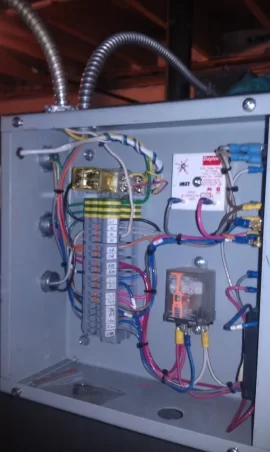

Wood gun installation help!
Okay my boiler guy was here today and got my new e140 all plumbed in, the boiler should be ready to fire, except we couldn't figure out where the thermostat (tt) from the house wires in.
I was under the impression the thermostat was wired right into the control panel. (I have auto oil, low temp shut down, and cycle timer). We could not find anywhere that this was indicated in the wiring diagram.
Is there an external relay that needs to be installed on the outside of the unit? We tried calling AHS but I guess the tech guy isn't in the office. :(
I just want to get my new boiler fired up.

Craig,
A typical fossil fuel boiler will use TT to only fire when there is a call for heat.
The WG doesn't wire in like a typical boiler. Basically you give the WG 110 power and it "runs". The aquastats will control the boiler and keep it "hot". It's up to you and the rest of the system to take care of the rest. I installed an ice-cube relay to turn on my circulator pump when the end switch on my zone valve closes after the thermostat opens the valve.
You can see the relay here:
