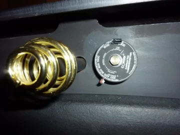

Here's a piece of tin foil I use to tell me where the cat probe went when I was gone.

Da meters.
