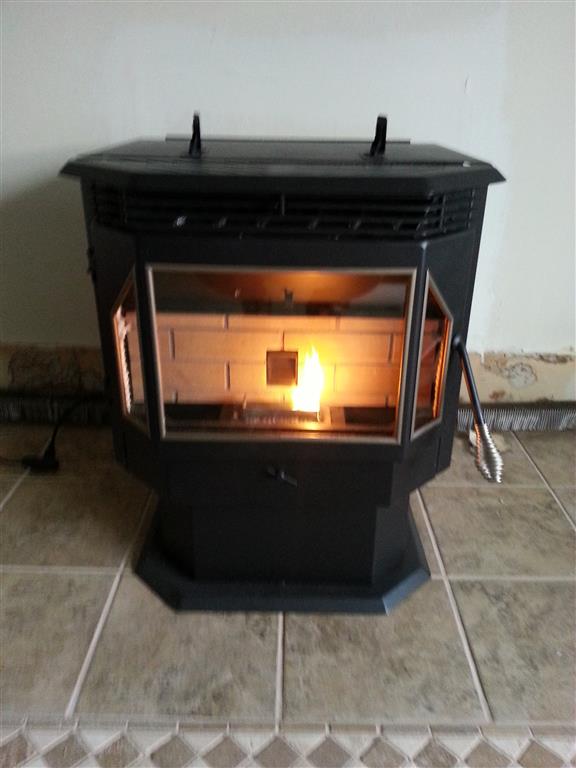

Got the pellet stove installed over the weekend ahead of schedule, this way I have have the place nice and warm for when my family arrives for Thanksgiving break. Unfortunately with less than 24 hours burn time, I've joined the auger squeak club. It was horrible, incessant, and I couldn't get to sleep. I finally hit my breaking point and got up at 1 am and spent an hour and a half shutting the stove down, emptying the hopper, fiddling with the auger, and finally shaving pencil lead down to lube the auger with graphite. Against all odds, the pencil graphite actually worked, and it was squeak free until morning, when it finally started whining again.
I've read different resolutions; some people just use graphite, some realign the auger, others simply wait for the auger to wear in, and someone even filed the auger down to prevent binding. Any suggestions on what method to try first? Any suggestions would be very helpful.
Anyway, Heres the stove:

Looks good! Sorry about the auger squeak!

Try some different pellets before you tear things apart. In my stove, North Americans, Easy Heat, and Eco Flame pellets all made a terrible racket. For whatever reason, when I switched to different pellets it went away. North Americans are a terrible pellet in most stoves. Try something different first.
I actually have an un-opened container of graphite because of that situation. Never had to use it after I switched pellets. It's probably a bur or something that will need ground down, but try the easy fixes first!
Its really not that big a deal for me to tear it down, or so it seems. Judging by the sound, I don't think its a burr so much as a rubbing. It happens for 2 or 3 cycles once every revolution of the auger, so I suspect something is a little oblong, and as the heat gets to it, it begins to bind inside the bore. Id love to fix the root of the issue rather than cover it up by changing pellets, but perhaps ill try a different brand first. Unfortunately pellets are not as popular here as they are in other parts of the country, so selection and availability is somewhat limited.
Thanks for all the suggestions everyone. Ill post up my progress. Aside from the noise, the stove has been great.
Happy Thanksgiving every.
Just wanted to post that I have been able to subdue 90% of the squeaking by running the blower a little higher. Seems that the squeak is far more prevalent when the stove is hot, and by simply keeping the blower speed a few clicks above the heat range, I can effectively keep the stove cooler. I haven't tried any different brand pellets yet, but I hope to pick some up this week.

Just an update:
99% of the auger squeak has been eliminated by using hardwood pellets instead of hardwood/softwood blend, and by playing with the room blower speed to bleed off excess heat. Seems once the stove got really hot the auger may have been expanding in its bore causing the noise. And certainly the extra pitch from a softwood blend wasnt helping matters.
Thanks for your help!
