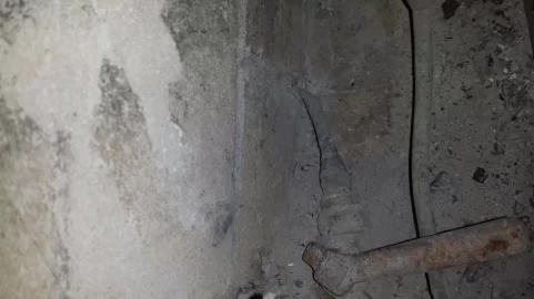

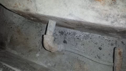

Here are pictures of where it comes in the house and where it connects to unit. Please ignore the ashes. Thanks!

That looks very much like copper running to the valve. If that is the case it would be used to run a gas log set - NOT a starting finger. Copper can not handle the temps of solid wood burning. Is it still being supplied by gas? I would not be burning wood in there till I could verify safety. Somebody with a keener eye than I have needs to look at this, either on this site or calling in a pro.
calling @DAKSY
I cannot tell what those pics are showing. I can see a shut off & what appears to be a flexible (3/8") copper line.
I see a BIP 90 & a BIP nipple either going into or coming out of the wall. Do you have LP or NG coming into your home?
What does the "unit" look like?
