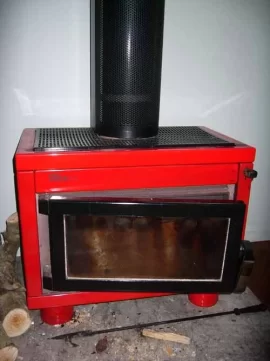

If you can take a photo of the stove and another one of the stove interior and post them here, that may help us spot something.

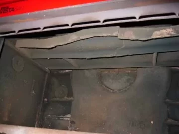

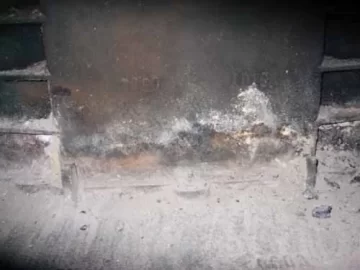

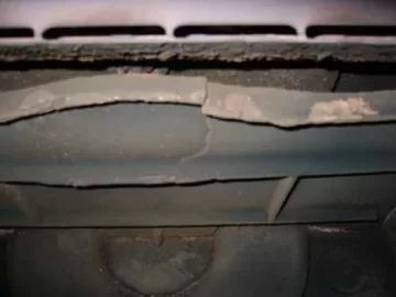

No fire as I am finding there is no point due to lack of heat. So photos attached. The top plate (is that the baffle?) is cracked by the looks of it.

Great. Nice looking stove!
Hmm, that baffle doesn't look in great shape. It appears warped and cracked. But this is my first look at one in a Stack.

One thing. That baffle in that stove has to be installed upside down. Has to be. I dont' know anything about that stove but I cannot imagine a baffle with the reinforcements on the bottom. And the lip on the front of it should be directing the exiting exhaust gases up and over the baffle, not trapping them behind the flange in the front.
You should be able to remove the baffle by lifting up on the right side of it and lowering the left side into the firebox. Try that and re-install it with the flat side down.

Your baffle is upside down, and cracked. I'm betting you aren't getting much if any secondary burn, which would rob you of about half the heat the Stack was designed to produce.

The Stack has an excellent airwash to keep the viewing window clean. The creosote buildup on the window in your picture could be the result of the broken/upside down baffle, but could indicate you are burning green or wet fuelwood.

Still no joy getting the top baffle out, i don't want to hit with hammer as it is cracked and already a little chunk has fallen off it.
