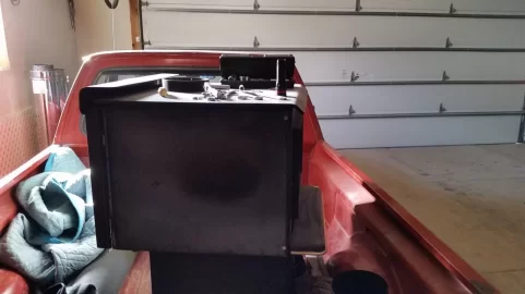

I checked the stove over top to bottom and all the corner welds are still intact around the inside of the door way along with all the seams around the inside and outside of the firebox. It does have two small cracks on the outside of the face of the stove, one on the top right side of the door and one on the top left side of the door. These are cosmetic according to all the threads I have read on this stove and I am capable of repairing should the need arise. The top and sides of the firebox are straight and flat, the top of the stove is the same. All the exterior shields and the door along with the glass are in good condition.

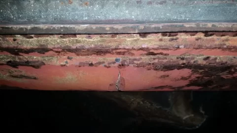

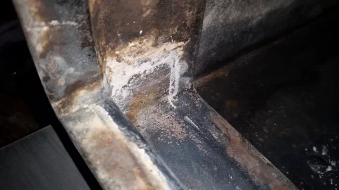

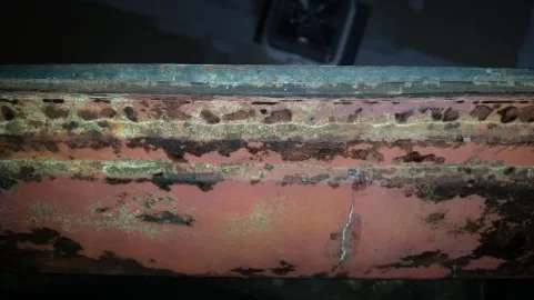

The only warping on the stove is a slight bow in the air wash metal along the top of the door. This is due to the shield that is welded on the back of it bowing as it was the center of what must have been an incredible hot spot. That piece of metal that is welded onto the air wash has a heat crack on it that I can clean up and weld up so as to not affect performance though it does not penetrate the metal so should not effect performance. The first picture is looking up at the issue from the bottom of the door. The grey metal is the bottom of the air wash metal the oxidized at the very bottom is the plate welded on and you can just see the crack. The next picture shows the crack well.

The crack inside the front upper is not something that was one of the typical issues of the years they had issues.

Are there heat shields outside on the sides? What are those two screws of bolts on the front vertical corner?
Whether those sides are the firebox, or heat shields, that haze is a good indicator this thing was run way too hot, way too long, way too many times.
But, if the sides, top, back etc are all solid and straight, I'd fix her up, paint her and run it a year or so, see if you like it, then decide whether to keep it or not. You can always resell it at any time.

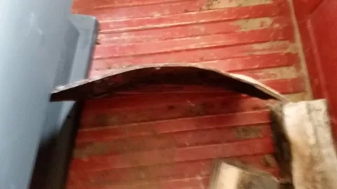

When you say flame shield, are you referring to the one that rests over the top insulation, or the one that is at the inside ceiling of the stove the runs from the air wash to the outlet and is bolted to the outlet? By flame shield I mean the one on the inside of the ceiling from air wash to outlet.
The one on top of the baffle insulation always warps some, no big deal there. The stove ceiling shield should not be warped. Here is a pick of the flame shield

Are there heat shields outside on the sides? What are those two screws of bolts on the front vertical corner? Heat shields slide over those two bolts then screw on at the back. The shields are in good shape and show no bad effects from the over-firing.
Whether those sides are the firebox, or heat shields, that haze is a good indicator this thing was run way too hot, way too long, way too many times. Agreed

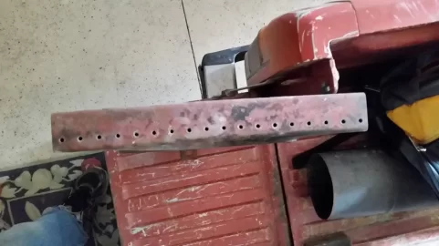

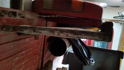

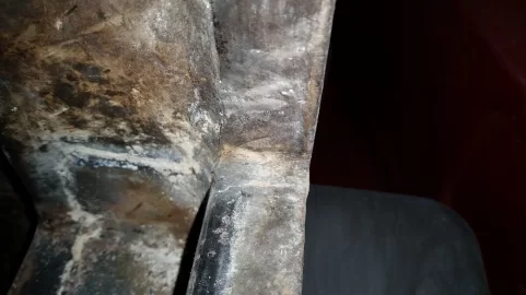

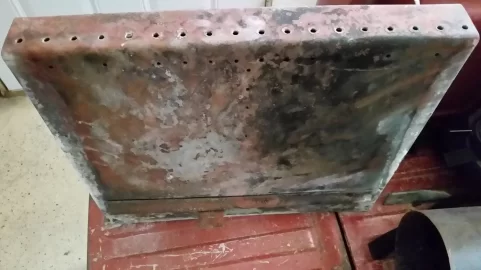

What does the baffle look like, still in decent shape? Here are a couple pics of the baffle, it is not horrible almost looks swollen bowed up on top and down on bottom.

The baffle is in good shape believe it or not.
My newer baffle looks worse than that.
The flame shield is pretty bad. Not sure what it costs from PE, but you could also get a local sheet metal shop to make one, or even buy a small plate online, that is all it is.

Hogz, thanks. I think the baffle looks okay, it has one weld on the stainless that has failed, I have a bud who can fix it if he thinks it is fixable. I am missing the sheet of stainless for on top of the insulation and the insulation blanket. The two pieces of insulation that go on the sides in the brick rails are still there and look good yet somehow. Any suggestions on what type of insulation I could use to replace that top blanket. I think I can source a piece of stainless for on top of it.

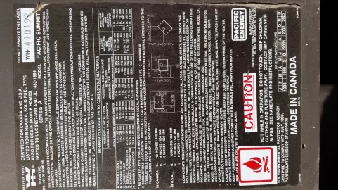

The placard on the back of the stove says it was built in July of 2000. Sorry it's sideways.

I don't think 2000 was a know problem year, unless the owners didn't speak up.
I had a 2006 and I think 2006-2008 were the problem years.
The one you got probably had the piss run out of it.
