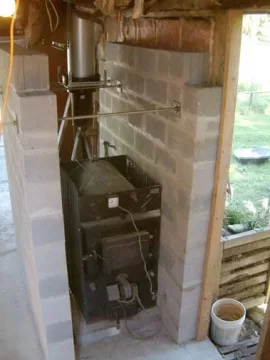

Hard to tell from the pic, but the bypass damper handle in the top center is identical to what's on the Royall boiler I had. I just happen to have a pic handy.
  • [Hearth.com] Help picking new stove/furnace...
