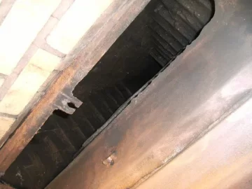

I had the same or at least what sounds like the same problem when I did mine. I to have a curve or bend at the bottom before it comes through the damper area. The liner got hung up on the 2 flue tile from the bottom just before the smoke chamber. Possibly on some cement sticking out on one of the seems.
After about 2 hours of twisting and pulling and pushing I grabbed a broom handle and jammed it up the smoke chamber until is stuck about 2 feet int the liner. I pushed and pulled hard on the handle and that freed up the edge of the liner just enough to allow it to slide down below the last flue tile and it was home free from there.. I was surprised how it got stuck that way and realized the flexible liner is not a flexible as I thought. Not sure if your issue is the same but it's worth a shot..
here's a pic before the liner went in..
