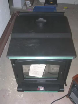

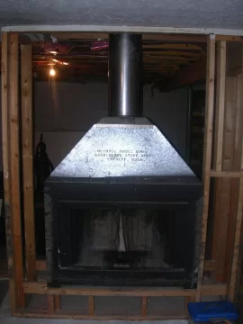

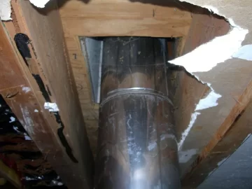

hello, I just joined this forum because there is a ton of useful information on here! I'm hoping to get some suggestions on a project I am just starting. I have a ranch style home built in 1978. It has a fireplace unit in the basement, that I am going to remove and replace with a new wood stove. The fireplace has 8" triple walled chimney pipe made by "SelKirk MetalBestos" that runs through the 1st floor, attic, and out the roof. The chimney pipe does not appear to be fastened to anything and is resting on the fireplace unit (see pics). So here are my questions:
1. How do I remove the old fireplace??? Do I need to remove the existing chimney starting at the roof and then remove the fireplace, or can I secure the chimney to the floor joist and then drop the fireplace down? It seems like pretty heavy pipe and I'm not sure if a bracket will be enough to hold the weight of all of it. I don't want it all to come crashing down when I drop the fireplace!

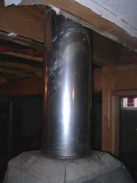

5. If you look at pic 4, the chimney pipe is rated for 2" clearance from combustables, but it looks to be about 1/2" from the floor joist. Would it be safe to make a connection using an adapter this close to the wood joist?

Oh wow. You have a manufactured fireplace vented into a selkirk chimney. There are a few things to consider here:
1. The chimney is supported by the fireplace and therefore needs to be removed in order to then remove the fireplace.
2. First and foremost, while the chimney for this fireplace does look like good Class A chimney, many manufactured fireplaces do not use true Class A for their chimneys and are listed and tested differently. You need to positively verify this chimney can legally and safely vent your stove. There can be a very big difference between the two types of chimney.
3. To reinstall the chimney, you will have to obtain the proper Selkirk parts, such as ceiling support box and such to complete the reinstallation as required for a wood stove.
Once the 8 inch chimney is installed properly, its just a matter of increasing the connector pipe to 8 inches and properly attaching it to the chimney with the proper selkirk connector.
Again, I stress that you need to positively identify that chimney pipe and make sure it can be used to vent a wood stove instead of a fireplace. I can't read that sticker too well. I'll see if I can pull it up on a different monitor and get a good look at it.

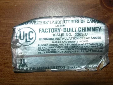

Says on the picture of the label from the chimney that it can be used with equipment normally producing flue gasses below 1000 °F. Class A chimney is rated way above that, and required by your stove manufacturer 2100°F is the requirement for my stove and I am sure, all wood stoves.. So my take is that you will need to replace the fireplace chimney with proper class A chimney. That's what I had to do also.
thanks Dakotas Dad.
I read through the user manual again on my new stove (Englander 30-NCH) and the manual states the pre-fabricated chimney must be listed to UL103HT (Class A).
I REALLY appreciate all the replies I've received on this forum. I thought this should be an easy drop the stove in and hook it up, but I guess not. Sucks I have scrap the existing chimney, but I'd rather be safe and not burn my house down!
