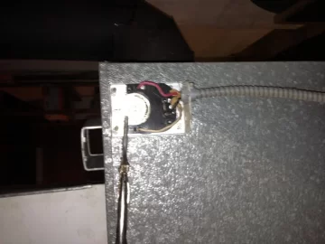

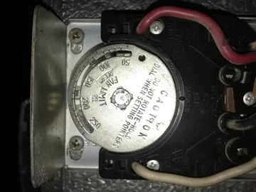

So the first problem... It has two blowers. One for forced air and another for auxiliary blower. It has a cut in cut out switch and I have my three pins set. With not moving the dial at all the auxiliary blower runs, but never shuts off and runs the blower for forced air. How should that whole set up properly work?
The dial on the switch is vice gripped in a position where both blowers run. I know what I'm doing is wrong but it's all I can do to spread some heat around the house and keep my fire going.

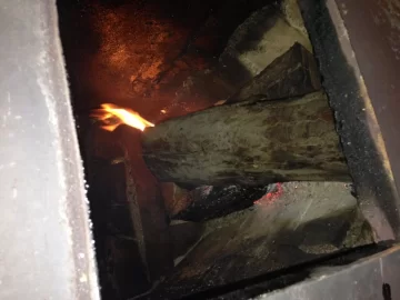

My fire has been going the whole time. Small flames and more smoldering than anything. I'm not really sure where to start to figure this out. We have two thermostats upstairs in the house. One for a boiler and one for the burner. They read about ten degrees apart. New thermostat on the wall? New cut in cut out switch?

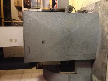

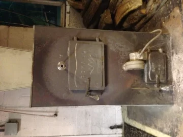

Welcome Jake. Is this a wood furnace or a wood boiler? Is there a model number on this unit? It will be something like model 8130 if a furnace. The controls definitely are not meant to be clamped in place. That could be dangerous, especially if it is overriding the limit controls. Post some pictures of the unit for us to see what you are seeing.
It is a wood furnace. I'm not sure what model it is. As I've read but still don't understand why it is, when I opened the door the fire does start to take off a little.

The majority of the time this is due to poorly seasoned wood. But it could also be that the chimney or the chimney cap is clogged. If so it must be cleaned first.
That is some large wood you are trying to start. If the flue is clean and clear it'd be better to get a coal bed started first with some construction scraps of 2x4s. Then put on the larger wood.

The wood that was in the picture had been in there for probably 4 or 5 hours. Nothing really catches for me. It all just kind of mostly smolders. The wood is seasoned. Probably not quite as long as it could be but it is. Thanks for the manual. Ill take a look through there.
