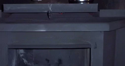

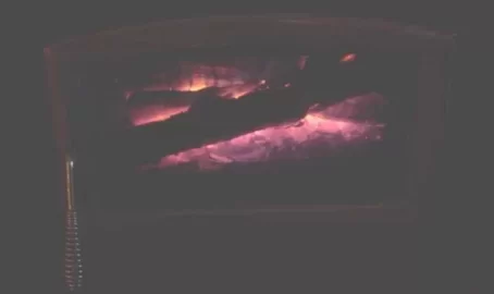

ok, so its installed
earth stove bv4000c
I cleaned the combuster, not broken up, was slightly black, its clean now, all passages are clear.
re sealed the door and glass.
air control works well, instant response, and almost able to snuff the fire.
getting top temps of 300 or so unless I leave the air intake open.
gets up to 500 top of stove temp after a while.
is it safe to engage the cat combustor with some questionable wood if the wood has been in there and is burning to produce these temps?
( its raining sleeting outside, so all of my wood is wet)
ive been splitting it up in the garage, but its wet on the outside.

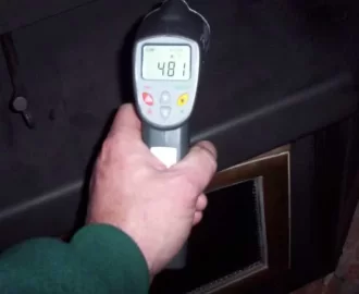

I do have a non contact thermometer ive been using the last few days, a point and shoot infrared type of deal.
shooting inside with the door open, im seeing 700+ on the flame guard of the cat before Ive tried to engage it.

check out www.condar.com see if they have one cheaper , shoot 100.00 is right pricy , we carry one for our catalytic models for 36.39 and s/h , not sure if it is the right length for your unit but its still considerably less than a c note. anyway , shooting the impingement plate and reading 700 F is probably giving you enough of an accurate reading to know you are active so i guess that would work just fine too.

I see this one.
(broken link removed to http://www.condar.com/meters.html)
3-12 cat combustor probe.
But, I need one that reads on the side of the dial, as the face wont be visible, the hole for the probe is in the firebox, the outer shroud is over it, and only about an inch tall.
if you can see in this photo, a dial that was read from above would be obscured from view.
