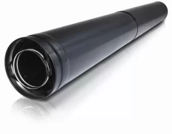

its free standing, pretty straight install. 4 inch pipe straight out the wall with an outside air kit on it. piece is no longer than 2 feet long total. i dont know what this is magnahelic gauge. as for the flame on low you can barely see it in the burn pot on high its a pretty big flame
thanks
4 inch pipe straight out the wall with an outside air kit on it.??????
Are you saying you have just one pipe out the wall? With an outside air kit "on it"?
If you have an OAK, then you would have two pipes through the wall....( in most cases ) It sounds like you have just one pipe going through the wall....if so that is half your problem. Can you describe the OAK kit that you put on the end of this pipe.....? Your exhaust port and fresh air intake are two different ports....
You should have a very decent flame even on heat 1...
Still think your not getting enough air.
The oak goes into the same pipe as the exhaust. the pipe has a 4" center pipe with a gap around it that makes the pipe a total of 6.5" the exhaust runs through the center pipe and the fresh air comes in through the gap around it. there sealed from one another.
