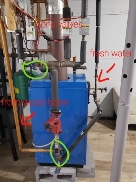

I had to drain my system to fix something but now I got all the water back in and I don't have air vents on my rads so I was told to only have the zone valve open that I want to bleed and hook the hose to the drain that I circled green and to close the ball valve at the bottom that I also circled green it seemd to work and I get heat to my rads but now the pipe that is coming from my wood boiler to the oil boilerwith a circulator pump that I show in the pic I keep hearing sounds like rushing or gushing water all the time like there is still air or something! Did I bleed it wrong was I supposed to leave the valve I circled at the bottom open while I bleed it?

It seems like I have got all my zones bleed and I am getting heat from all my rads, but when I light my wood boiler and it gets up to temp I can here water like gurgling or gushing or something inside the boiler where I circled. would this mean I still have air? My temp on the boiler is set to 180lo and 200hi it shouldn't be boiling water at this temp right? Also if it's air I have 2 new auto vents in the system will they eventually take care of it?

My rads seem to be not bad now and I'm getting heat but this pipe that runs from my wood boiler to my oil boiler I'm hearing like gushing sound constantly right in the wood boiler itself and if I shut the ball valve off by the circulating pump it stops the noise is there a way to bleed this out out of my wood boiler also or maybe my wood boiler is bad?

It does sound like you may still have air. I believe the valve your talking about is for draining the boiler not for bleeding air. Any air to be bleed would be at the top of your system , your blow off or pressure relief valve is at the top of boiler not the top of your system.
Don't turn the valve next to circulator off unless you want to burn it up.
Ya that's what I'm thinking still air! in this pic is how I bleed all 4 zones where I hook the garden hose up and the valve I shut off are both circled green I just manually open each zone valve one at a time to bleed each of them! Plus I got an auto vent not sure why I can't get all the air

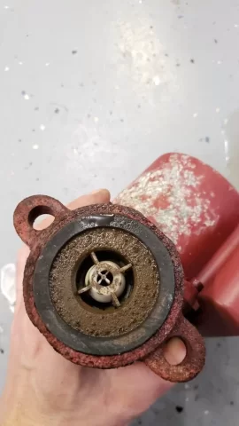

Also I just bought a new circulating pump and this is my old one the impeller seems to be really hard to spin I didn't get the new one hooked up yet

what you see in the picture is not the impeller,it's the check valve.
Ok do I need a check valve cause I just put my new circulating pump on it didn't come with one but someone told me it was ok to put it on without it
The check valve is to prevent reverse flow, you may or may not need it but I don't think that is what we are talking about anyway. If you have water in your overhead tank it would seem that your system is full. Have you been able to heat house with wood boiler alone since repairs were made ?
