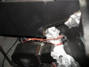

I got behind the stove (sort of). I think I found the disk with the 2 electrical wires to it. But I don't see any hose connected to the disk. The disk is just flush against the back of the stove. The other side (the face inside the stove) is not the actual firewall. If the back of the firewall is flat, then where this disk is mounted is on the left angled piece. In the manual, it's basically above where Door #1 is. It could be that I'm not looking at the correct disk with 2 electrical wires. But if I look to where the square should be based on the picture in the manual, on the back of the stove opposite that part just looks to have some fluffy insulation there. Am I looking in the wrong place?
The venting is 4" diameter flex and it looks pretty straight and smooth. no kinks, and looks brand new (which it is).
Here's a picture of what I'm looking at.

I will look into it but from the pics I see you do have an old stove. That looks like the high temp thermo disk. The air switch should be in the center of the back of the insert. What year is the stove? I have seen these old units but never worked on them to give advise. I would talk to who you got the unit from. It might be something simple but I know Breckwell had an issue with the analog boards and did offer an upgrade kit to the digital board.

Ok, is this the air switch? (see pic below) I think I found it. I wasn't able to disconnect the hose, but it seemed to be ok. I mean it wasn't brittle at all. It seemed flexible and, while dirty on the outside, appeared to be in decent shape.
With this older P24I model, is it possible that I damaged the air switch? At one point, I did open up the 3 doors in the combustion chamber to try and vacuum stuff out of there. With this older model, I don't have that 1/4" square on the rear firewall. Is the air switch connected to one of the chambers behind the doors?
I tried lighting the stove again this morning and failed. I tried to time how long the combustion fan stays on and it stays on 30 sec and then shuts off. I'd turn it back and 30 sec later, shuts off. After a few minutes (5 or 6 times) I just gave up and let the fire (a nice fire by the way) die out on its own.
Does this sound like a bad air switch? Or could this still point at a gasket issue? I'm at a loss.... If is it the air switch, on this older model P24I, is changing out the air switch something I can do myself? Or should I get someone in to do it?
