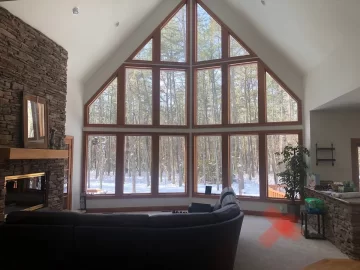

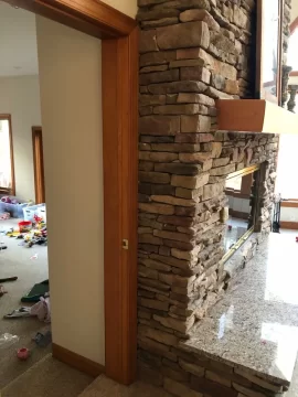

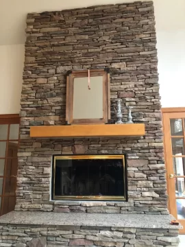

Looking for some help deciding between installing a ZC fireplace or a freestanding wood stove. I just moved into a house with a large great room. Has a beautiful stone wall surrounding an ugly prefab fireplace. As the house is large (and very expensive to heat), I'm looking for a way to supplement my heating (not replace entirely).
My goals are to:
1) Reduce my heating bill
2) Enjoy a nice fire
3) Be less reliant on the gas or power company should we have an outage
My options are:
1) Install free standing wood stove in the great room
2) Install a ZC fireplace (likely from both sides for access) but will need to pull down a good section of custom stone work for metals studs and hope we can get it back without being too noticeable
The free standing stove is certainly a cheaper option but adds an item to my floor space, requires a second pipe and doesn't help with the lost aesthetics of the prefab fireplace.
The ZC is going to be a bit more expensive and labor intensive but will be almost entirely reliant on the electric blower (minus the possibility of ducting into another room or maybe 2).
Seems as though heat output ratings for both are generally in the same ballpark. I'm leaning toward freestanding stove because of the total independence AND - why I'm posting - is because I'm afraid the heat output of the ZC won't be close to the wood stove despite claims by manufacturers. (although cost is a factor I plan to be here for 30 years so I'd rather do it right the first time) Not sure if anybody has experience with this or can help guide me.

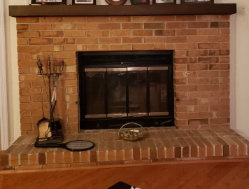

I have an old Heatilator MF36 ZC fireplace circa 1982. It is in a corner install. I am planning on staying with a ZC high eff fireplace. I need to remove all the brickwork, but its not that much, and will redo with a stone veneer floor to ceiling. I envision running this from when i get home from work til the next morning when i leave. I have a natural gas furnace, and only spend ~$750/year on gas total. Not much savings to be had for me. House is ranch, ~2000 sq ft. Needs a new chimney obviously. The SO doesn't like a stove anyways. Its more expensive for the ZC, but it will never be a primary heat source for me. I think it add more value to the house as a fireplace. I plan on staying here another 30 years too. I am maybe a year or two from starting the project. Looking at Osburn, Valcourt, Hearthstone. 2nd picture is what i envision it looking like, depending on which ZC i get.
View attachment 291371 View attachment 291372

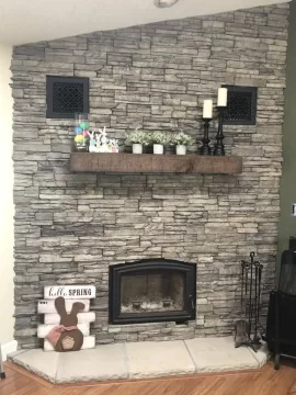

For what it's worth, I'm running two freestanding stoves in two fireplaces. One of those fireplaces had a ZC insert installed when I moved in, and I went thru a heck of a lot of work to tear it and all of the associated framing and masonry rework out, to replace it with a free-stander. No regrets, here.

Just to pile on, when we moved into our house there was an old zero clearance fireplace that had been hacked up to fit a propane insert. My wife loved the look of the fireplace even if it didn't do anything. I pushed pretty hard, unsuccessfully, to rip it all out and use that space for a wood stove but instead ended up putting in a Valcourt Lafayette. My wife and I put a lot of time into building it out and putting up all the stone, and it pains me to know that eventually I will need to rip it all down when I have to replace the fireplace with something else. For that reason alone I wish I had been successful in convincing my wife to go with a freestanding stove.

I appreciate the reply. Your comments about ripping it down again are what I'm stuck on.
Trying to be diligent I looked at all of the options thoroughly. Swapping my prefab for a high efficiency ZC unit looks like it'll cost somewhere in the 15K range. Not only will it be a tremendous amount of work to do, I'll be almost a guaranteed alteration of my stone work (which was custom done when the house was built and is in numerous locations throughout the house). I'd be willing to do if I thought I could get away with it once but eventually I'll have to repair/manage it thus requiring another partial rebuild. Plus, I'm not really getting a true off-the-grid backup heat source. Major downside is that I'll be placing a wood stove in the same room as this gorgeous 20 foot stone wall with non-functional (ugly) prefab fireplace.
Being as this process is so extensive, I was able to convince the wife on the free standing unit. Trying to find a good location for it is the next battle (combination location in the room and routing of stove pipe with creation of new chimney). This might sound crazy but later on down the road I might covert the prefab to a gas unit for easy on/off usage and aesthetics.
I think I can place a bend in the stove pipe, and if so, that'll make the project a ton easier.

Can you post a picture of the entire room?
