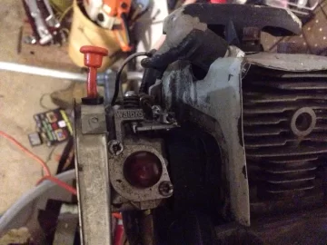

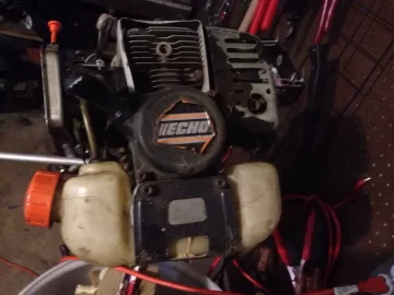

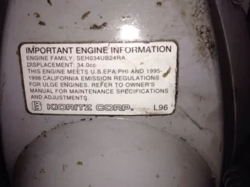

Do you know what's causing the hard starting issue? Once it's started does it run properly? The motor looks like it's made by kioritz , it's Japanese. Probably a carb issue if it's sat awhile. Take a look it's probably a Zama carb, easy to find parts for those.

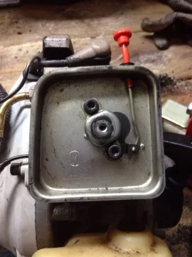

I'll try to get some more pictures of that helps. It will stay started if you keep it revved high. But if you leave off the throttle she dies. You can't just get it started and take your time putting the harness one. Once it fires you have to be pulling the throttle in seconds. And you can't just rip on it either. You have to feather it nice and easy until it reaches the top end. It's a real basket case. I think it needs new fuel lines air filters and plug too. I don't know how helpful echo dealers are but I will probably call one, maybe take it over to them to look at.

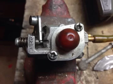

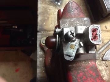

Well that's a Walbro carb ..==c

Well the dealer said they can identify Anything by the engine family number. Not sure what good that is. He said I could take it in and it would be $62 an hour to fix.

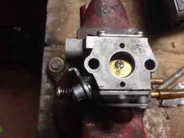

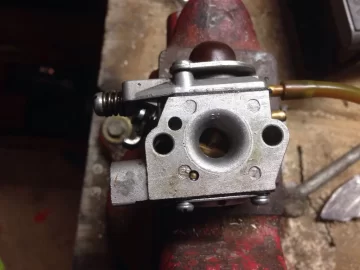

Sounds like a carb issue, it's always a carb issue (nearly). Take off the carb and get the #'s off of it. Walbro's web-site has info you need to determine which one it is. Often it's cheap enough just to buy the whole carb, if not do a simple rebuild with recommended kit.
That's what I'm thinking. I still need to get air filter fuel lines etc. filter shouldn't be to hard to find. And I imagine that I can use fuel lines and fuel filter from the hardware store. I was just hoping I could order it all up and tear it all down and install at one time. I'll just have to be more organized.

Talked to my father in law today. He said it is a SRM 3100.
Does that mean anything to anyone?
Try a rebuild kit ..carb looks a little gunky ..and go with new lines for shure!
That's what I'm thinking. New carbs are $48, kits are $15. So I'll try a kit first if that doesn't work a whole new one.

Engine firing regularly can output more power than bigger one which is not. A larger, heavier machine is heavier, not a plus. I still regularly run an Echo SRM-200, from late '70s. Still runs great with thousands of hours runtime on it. A few years ago it ran like OP describes. Carb diaphragms get cracked and cranky, a cleaning and full kit restored it fully. It works fine now with 12" 3-knife or 11" 4-knife Husqvarna blades or 9" Forester chainsaw-cutter blade, besides line head. A 20-tooth 10" carbide blade works great also on woody stuff to 3"+.

And ... OP's machine looks like it's been "rode hard & put away wet". Clean engines run cooler also, especially when abused with extended line-trimming.

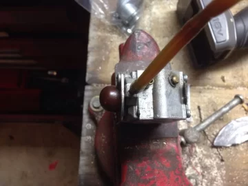

A modern rebuild kit can actually get it going better than the original parts were. The materials they make the diaphragms and such out of are always getting better at enduring ethanol poisoning.
Are you comfortable tuning those guys? Gonna need to do that too. (Guessing that the answer is yes since your limiter caps both have screw holes in them, but just checkin'.). ;)
My guess would be that it sounds lean. You could try turning out the idle screw a 1/4 to 1/2 turn. The idle screw is the one on the carb. closest to the engine. Carbs on eBay are usually a lot cheaper.

Well I haven't tuned anything well. My father in law is who messed with that one. So I have been watching YouTube examples of it, and hoping I can figure out.
