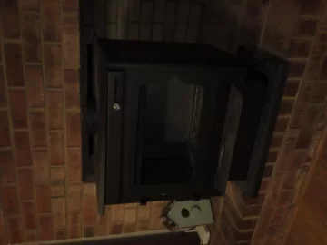

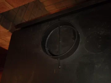

OK, next question: here is a picture of the stove, it is slightly different from current models (I do have the door and firebrick). The air inlet is on the top in mine, and on the bottom in current models I've seen. Anyway, what is the use of the baffle in the second picture? It is weighted such that it only sits closed; to open it you'd have to hold it in place. Is this normal? Thanks in advance.

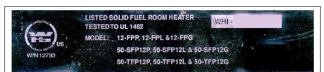

That sure looks like an Englander 12FP, not a 13 NC. Check the UL label on the back of the stove.

I hope the seller didn't deceive you and pawn off a 12FP and tell you it was a 13.:mad: Seems fishy.
I believe the 12FP is EPA exempt. Hence, no ceramic boards or tubes.
It was an honest mistake on his part--and I should have checked the tag on the back of the stove first. We've got it worked out and I'm shopping for a 13, again. Thanks all for the help though.
yes, its a 12-fp it is EPA exempt and is rated up to 1K sq ft max coverage. a nice room heater (FP stands for "Freestanding fireplace" its not a "whole house" heater by any means) though a nice little stove.
a tidbit, its the only 35-1 AFR exempt stove that actually has a draft control built into the stove. burns a beautiful fire, but if heating a house is the plan, she just doesn't have the muscle to do that very well. more a room heater, or ambiance stove than a serious home heater.
to the OP first thing you want to look at is the draft control. ay 13- nc built before 2004 will have a draft control above the door like the 12 you pictured, however the cover for the control will have slots in it where the 12 control cover is solid in front. later models are "mh" versions , meaning they have been engineered to accept an OAK which is a requirement for mobile home use. this version will have a pull rod under the ash lip.
