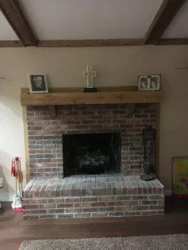

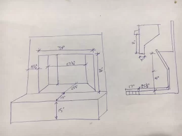

So we just bought a home out in the country and after 3 months of winter I'm already tired of paying the LP bill. I'd love to start either supplementing or completely heating with either wood or pellets. I'm really trying to do the most amount of research as possible but I just keep seeming to confuse myself with all the options. Any help you guys could provide would be awesome. Heres the run down of our home.
We live in a 1620sf ranch. We have an existing masonry fireplace with no insert or anything in our living room which is the middle of the house. The living room has cathedral ceilings. The kitchen/dinning is to the left of the fireplace and is open to the living room and had 9' ceilings. The three bedrooms are to the right of the fireplace and down a hallway. The bedrooms also have 9' ceilings. This is a 1970s brick home and definitely has some air leaks. The insulation is the attic is average at best but will be updated this coming summer. I've attached the dimensions of our existing fireplace. We are completely open to pretty much all options that will occupy our existing fireplace space. We don't want a stand alone stove in the corner of the room but aren't opposed to stoves that sit partially in the opening and extend out onto the hearth. My wife seems to like the looks of Quadrafire Voyager Grand the most. Looks are important but efficiency is probably the highest on our list.
Now for the slightly complicated thing. We have a nanny that takes care of our two little girls at home during the day. Whatever we get I'm hoping to have 10-11hr burn times while I'm away from the house for work so the nanny doesn't have to mess with adding wood. I usually walk out the door at 7am and home by 6pm.

I’m confused about your drawing on the right. You say the opening is 26” tall but inside to the smoke shelf or damper is only 14” is that right or am I misreading what that is?
Also a lot of inserts stick out from the opening especially the princess so unless your floor in front of the hearth is non combustible you may need a hearth extension board.
Lopi Rockport
Blaze King Ashford 25
The 14" is the break point of the back wall where it starts to angle toward the front opening. Total opening height it 26" The hearth kinda complicates things as well. We have hardwood floors. The hearth is built up 15" aff and is only 17" deep.
So a measurement you will need to know also is the depth at the top of the opening as some fire boxes are square and will fit just fine at the bottom but would hit at the top before all the way in. Or find the inserts dimensions you are interested in and see how far they go in and the height of them to see where you need to measure from. Seeing that it is 25” deep most inserts should fit no problem as most are no where near being 26” tall just have to make sure it will clear in the back before the angle up top.
The princess definitely would fit but since it sticks out 12” you would definitely need a hearth extension board at least.
On my hearth it was 16” from the opening but the ashford sticks out about 4” so I have a board down in front of the hearth.

How much clearance is needed from the unit to the edge of hearth? Also, from the top of the opening straight back is 19-1/2" deep. I'm planning to re-veneer the entire fireplace. I plan to take it all the way to the ceiling with metal studs and cement board and them complete cover with cultured stone veneer. If abosultely necessary I could build out the hearth further into the living space so its all one level. I plan to pour a tumbled edge concrete hearth.

Questions: How tall is the chimney from firebox floor to the top? What are the inner dimensions of the flue liner in the chimney?
So the ID is great, there should be plenty of room for an insulated liner. They height is marginal,.This could affect draft performance. Some stoves are really fussy about draft and need at least 15-16' of flue. There are some inserts that will work ok with a shorter liner. If there are dealers in your area you might want to also look at Pacific Energy and Enviro inserts for this reason. The other option is to extend the chimney a few more feet to increase draft. The larger inserts made by PE and Enviro will provide 10-12 hr burn times and work ok with 13' flues.
Or the chimney height can be increased by a mason, a class A extension, or an extendaflue topper.
